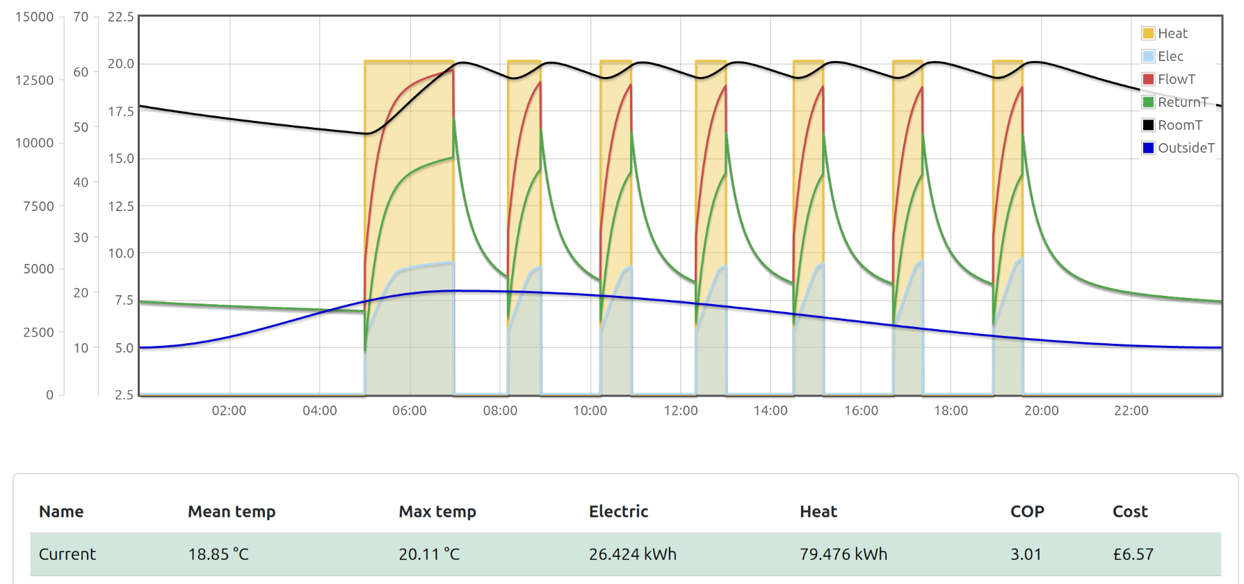

The key issue here is that the system is ramping up to much higher flow temperatures than required, the system is then cycling on room temperature, turning on and off on the thermostat.
Dashboard link: https://eoh.heatpumpmonitor.org/emoncms/EOH2578/app/view?mode=power&start=1645488000&end=1645574400
The long off periods (~1.5 hrs) visible between the high temperature cycles together with the fact that the compressor is running at 100% when it is running, indicates an opportunity for the system to deliver the same amount of heat and comfort by running at a lower flow temperature and at a lower compressor modulation. This would result in a substantial improvement in performance.
The pattern seen here of the flow temperature ramping up to a higher flow temperature than required is consistent with either the weather compensation setting being set too high or the system being ran with a high fixed flow temperature target. The flow temperature and compressor modulation can be reduced by reducing the weather compensation curve setting and turning weather compensation on if not currently in use.
Simulated performance results: To get an idea of the performance improvement that might result from this change, we can simulate this system using our dynamic heat pump simulation tool. Use the following parameters to simulate the period from 9am to 10pm in the screenshot above:
  • Building heat loss: 5.5 kW (240 W/K)
  • Heat pump capacity: 12 kW
  • Radiator rated output at DT50: 13.5 kW
  • Control mode: Fixed speed compressor
  • Compressor speed: 100%
  • Limit by room set point enabled
  • Schedule: 19.6C all day
  • Outside temperature: 6.6C (2C oscillation)
  • COP model: Carnot (variable offset)
  • % of ideal COP: 45%
  • System volume: 150L

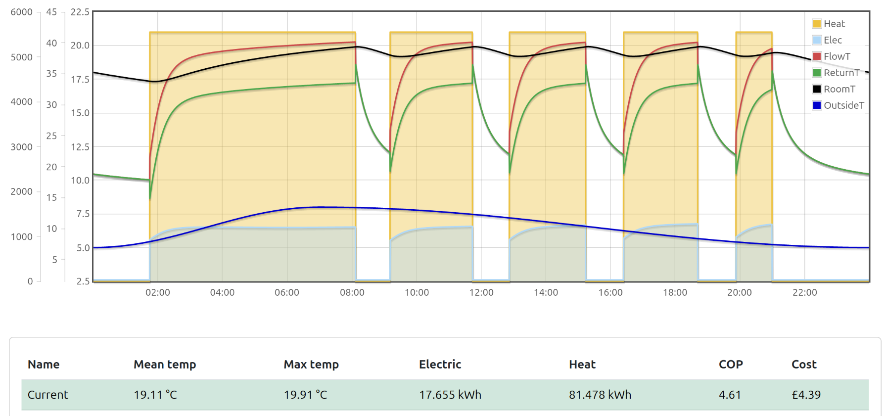

This simulation run, yields a COP of 2.87, 10 cycles per day and a max flow temperature of 57C, providing a good match to the real world data above.
To simulate the effect of optimising the weather compensation curve, simply reduce the compressor speed to the minimum required to maintain the same indoor temperature set point. In this case this is the minimum modulation of the theoretical heat pump which is 40%.
This simulation run, yields a COP of 3.88, illustrating the significant performance improvement that can be gained with this simple change. Further performance gains could be realised by
