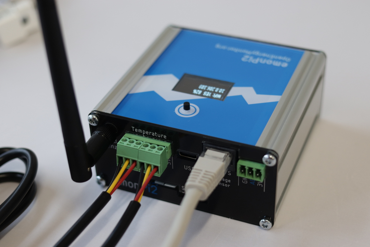

DS18B20 temperature sensors are connected via the labelled pluggable terminal blocks (multiple sensors can be connected to each temperature input, e.g using a 6x sensor breakout board). Please note that temperature sensing is not broken out on the RJ45 connector which is for voltage sensing and power only.
Pluggable terminal block connections are:
GND (black), DATA (yellow), 3.3V (red), left to right, repeated for each of the three blocks:
The function of the emonPi3 terminal blocks is configured in software (see the configuration information). The default configuration is for both inputs to be temperature sensor imputs.
The DS18B20 input is connected to GPIO17 on the RaspberryPi via the GPIO connection header. It is also connected to the microcontroller for use in transmitter mode as part of an emonTx6.

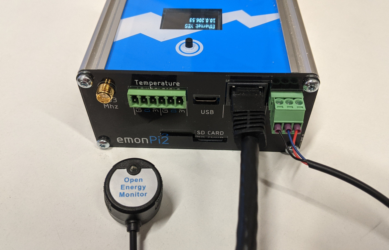

The OpenEnergyMonitor pulse counter can connected like this:
This pulse input will appear alongside the energy monitoring data from the emonPi3 on the emoncms inputs page. Note that the voltage sensor is required for this firmware to work.

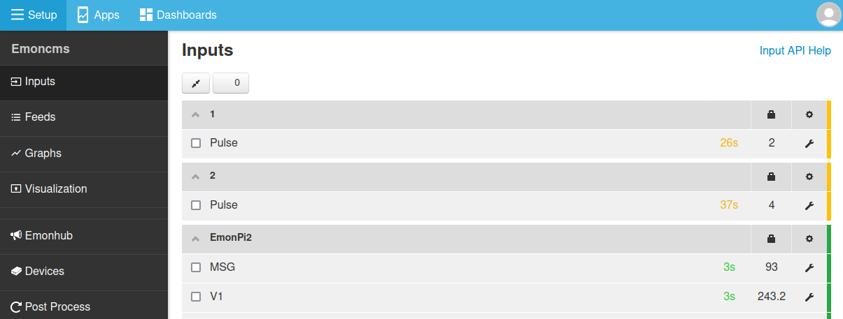

On pulse detection, the pulse inputs will appear on the Emoncms inputs page:
