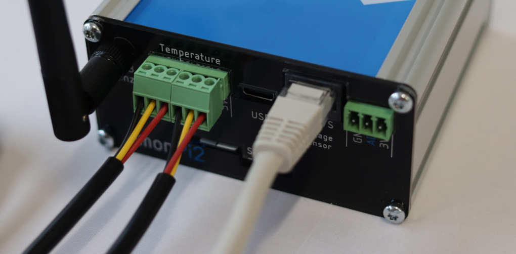

DS18B20 temperature sensors are connected via the labelled pluggable terminal blocks (multiple sensors can be connected to each temperature input, e.g using a breakout board). Please note that temperature sensing is not broken out on the RJ45 connector which is for voltage sensing and power only.

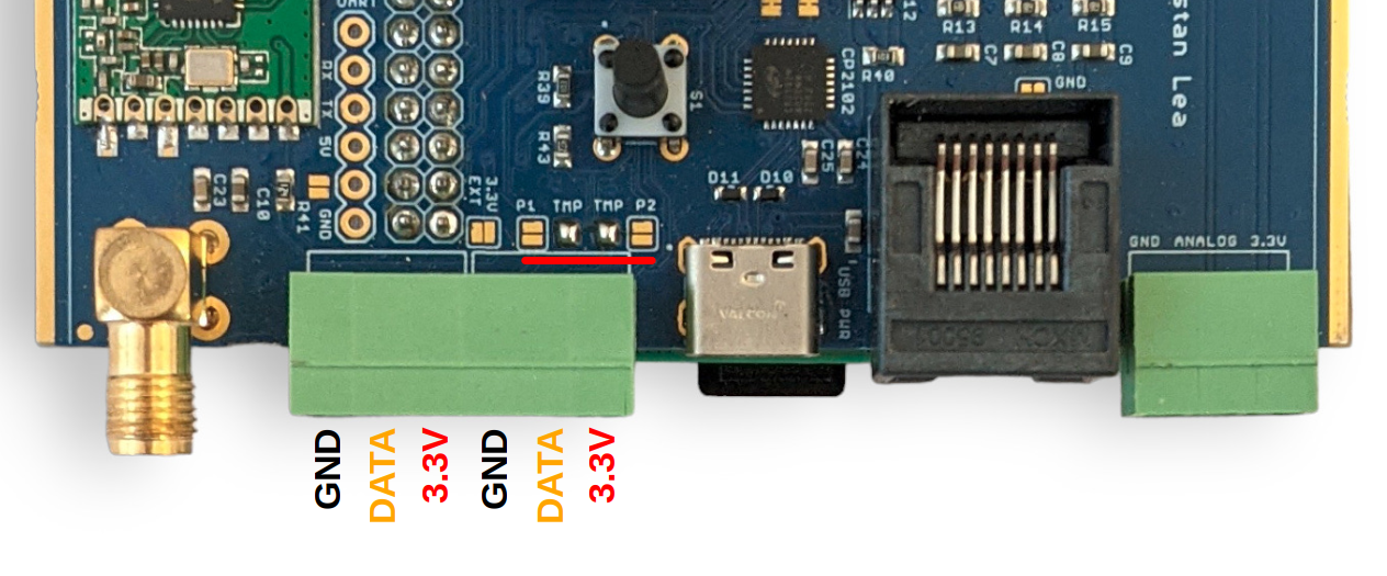

Pluggable terminal block connections are:
GND (black), DATA (yellow), 3.3V (red), left to right, repeated for each of the three blocks:
The function of the emonTx5 terminal blocks can be changed with small solder-jumpers just above the terminals on the measurement board PCB. The default configuration is 2x temperature sensor inputs, one on each terminal block. Notice the bridged solder jumpers labelled ‘TMP’ in the picture below:
The DS18B20 input is connected to digital PIN_PB4 on the AVR128DB48 microcontroller.

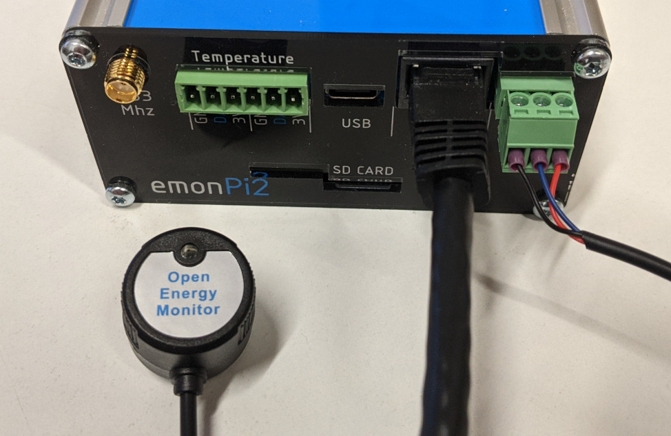

When running the latest emonTx5 single phase or three phase firmware, pulse counting is attached to the analog input as standard (consistent with emonPi2 configuration default)
The OpenEnergyMonitor pulse counter can connected like this:
This pulse input will appear alongside the energy monitoring data from the emonTx5 on the emoncms inputs page. For pulse counting applications without the emonVs voltage sensor connected make sure to be running the single phase emonTx5_CM_6CT_temperature firmware.

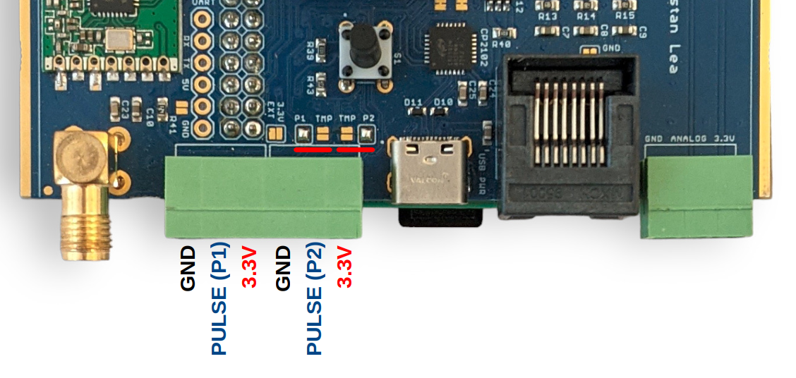

Pulse sensing using the terminals labelled ‘temperature’:
While the left hand side terminal block inputs are configured for temperature sensing as standard, it’s possible to change the function of the ‘Data’ pin on each of the terminal block inputs. The following picture shows both inputs configured for pulse counting rather than temperature sensing, notice the moved solder pad bridges:
Note
P1 can be either a pulse input (AVR-DB PIN_PB5) or temperature sensing (AVR-DB PIN_PB4)
P2 can be either a pulse input (AVR-DB PIN_PC0) or temperature sensing (AVR-DB PIN_PB4)

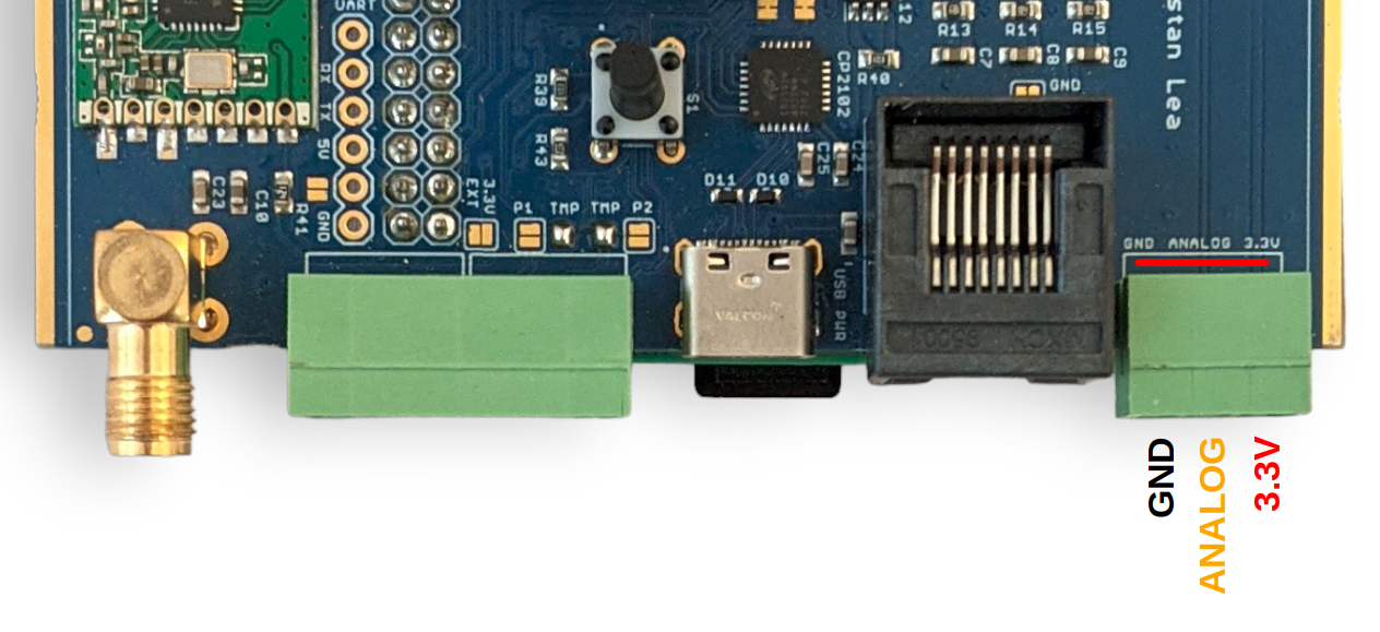

Analog input
When CT 12 is not required, it is possible to link analog input AIN19 (CT12) to right-most terminal block as shown here. An example application is measuring flow rate using a Sika VFS which has an analog voltage output.
Warning
The analog input voltage must be in the range 0 - 1.024V. This ADC is configured for this range in order to suit the 333mV CT sensors.
Warning
When using a 6 CT expansion board it is still possible to use the analog input in place of CT12 (leaving 11 CT inputs). Remove the header pin that links CT12 on the expansion board to the emonPi2/Tx5 measurement board PCB to do this.

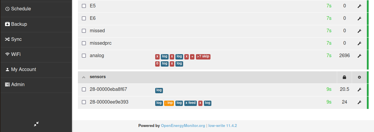

With this firmware loaded the analog input will appear in the input list.

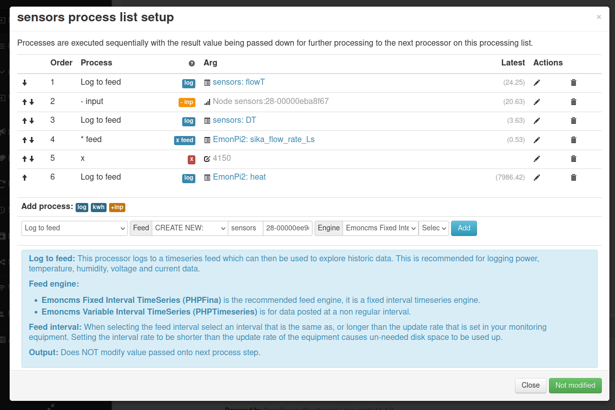

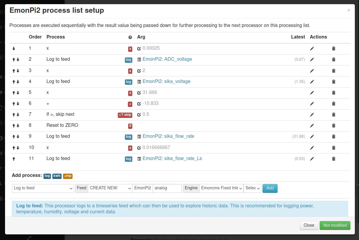

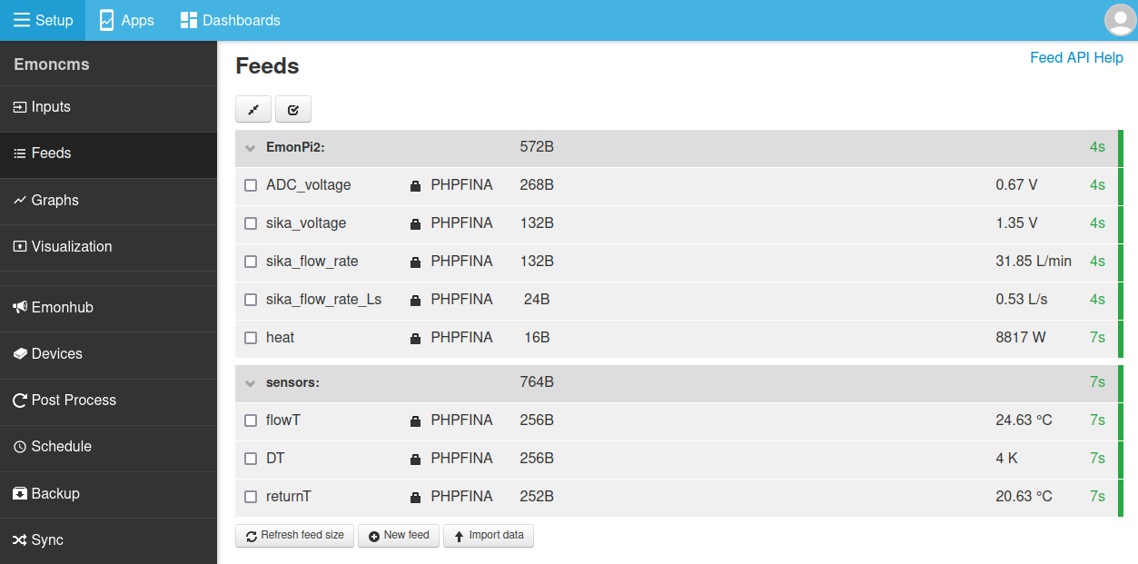

The following set of screenshots gives an example of configuring this analog input for use in reading the flow rate from a Sika VFS flow sensor. The flow rate is then used together with measurement of flow and return temperature to calculate heat.
These screenshots show inputs labelled as emonPi2 but the process is exactly the same for the emonTx5:
