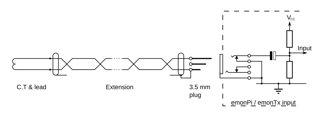

Remove the 3.5 mm jack plug from your CT (If it is moulded on, you must cut it off. If you do not wish to cut the plug off, obtain an “in-line” socket). Install the cable and prepare the ends.
Decide at which end of the cable you have a good earth connection. You must connect the cable screen to earth at one end only. If you have a choice, connect the earth at the emonTx/emonPi end. If you do not have an earth connection, then you may connect to the emonTx/emonPi’s GND.
At both ends, strip back the outer sheath. At the end that will be earthed, comb out (or unwind) the cable screen. Join the earth wire to the screen, and connect to the earth connection. At the end that will not be earthed, cut back and insulate the cable screen.
At the CT end, join the two cores of the CT’s cable onto the two inner cores of the new cable. Do not connect the screen of the CT’s cable (if it is screened).
At the emonTx/emonPi end, connect the two cores of the extension cable to the plug tip and sleeve. To maintain the phase relationship, connect the red core of the CT’s cable via the extension cable to the plug tip, and the white core of the CT’s cable to the plug sleeve. If you have an American CT with white and black twisted wires, connect the white wire through the extension cable to the plug tip and the black wire to the sleeve. There is no connection to the plug ring.

Theory
There are two routes by which interference can get into the cable, and so be measured along with the wanted signal – as a magnetic field or as an electric field.
The magnetic field is counteracted by twisting the cores inside the cable. Alternate half-twists will pick up the field in the opposite sense, so the induced currents will cancel. The cable screen will have little or no effect.
The electric field will be intercepted by the cable screen, and conducted to earth through the earth connection. It is important not to earth the screen at both ends, as this could give rise to a current that circulates in the loop formed by the cable screen, earth and the two earth connections.
