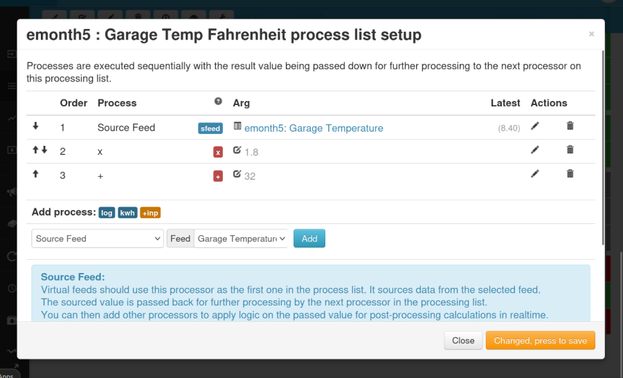

To add the processes, choose the spanner icon.
You will be taken to the Process List Setup page, which is almost the same as the Inputs process list page.
We shall add steps to convert the numbers in the existing Feed, “emonth5: Garage Temperature” (in degrees Celsius) to degrees Fahrenheit, using the well-known formula F = C × 1.8 + 32. The steps to add are
Source Feed. Select the feed from the drop-down list, and Add. [Note: you can’t set a feed engine or feed interval.]
Calibration × . Enter the value 1.8 and Add [To divide, enter a fractional value]
Calibration + . Enter the value 32 and Add [To subtract, add a negative value]
(Hint: Look in the blue box for a summary of the process’s actions.)
It should look like this
Click “Changed, press to save” and close the box. The Virtual Feed is ready for use.

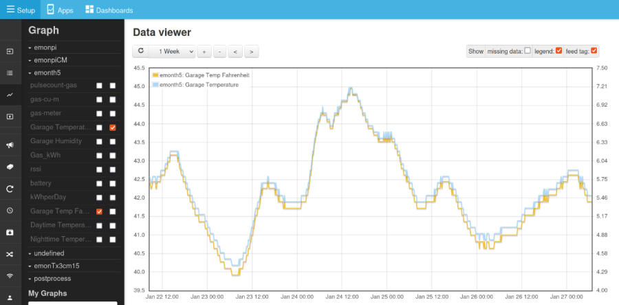

Using the Virtual Feed which converts °C to °F
Here is a graph showing, on the left-hand y-axis and in yellow, the temperature converted to degrees Fahrenheit, and on the right-hand y-axis and in blue, the temperature from the original Feed in degrees Celsius. The Virtual Feed is selected in exactly the same way as the other.

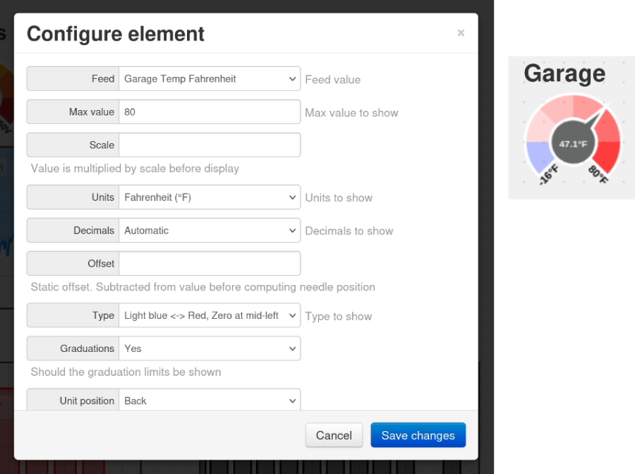

A widget on a Dashboard is configured by selecting the Virtual Feed in exactly the same way:
Each data point in degrees Fahrenheit exists only for as long as it takes to plot the point on the graph or change the dial. It is never stored on the SSD/HDD/SD card.

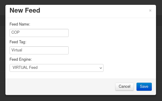

On the emonCMS feeds page, scroll to the bottom and click on New feed. In the dialogue that opens, select the VIRTUAL Feed engine, enter a Feed Name and (optionally) a Feed Tag, e.g:
Save, and you should now see the new Virtual Feed in your feed list.

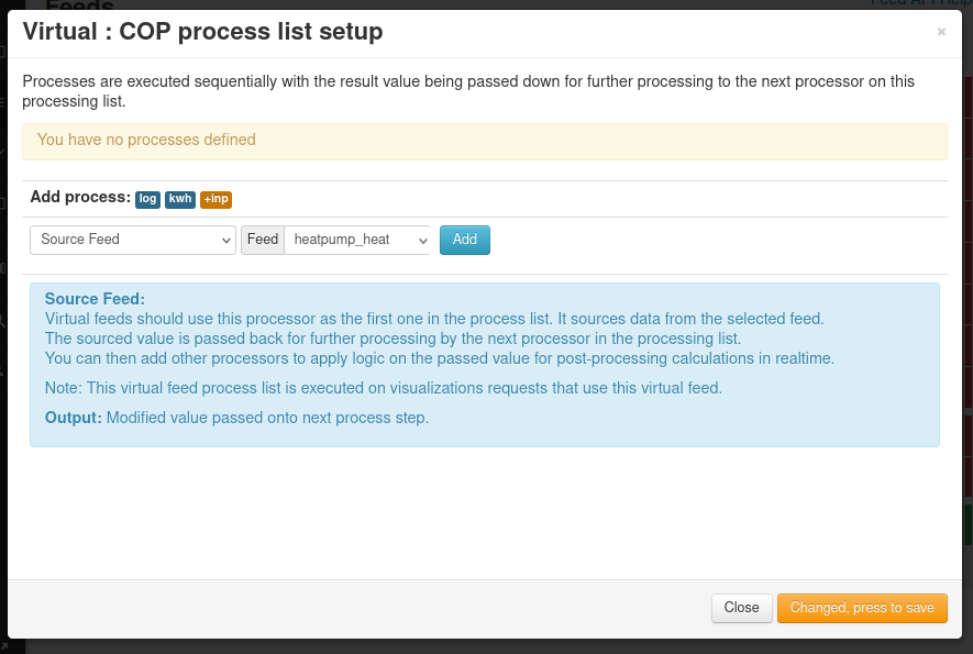

Click the box in front of your new Virtual Feed and the menu at the top of the page will expand. To add the processes, choose the spanner icon. The feed process list configuration dialogue appears:
Select the Source Feed process and select the “heatpump_heat” feed from the drop-down list, and Add.

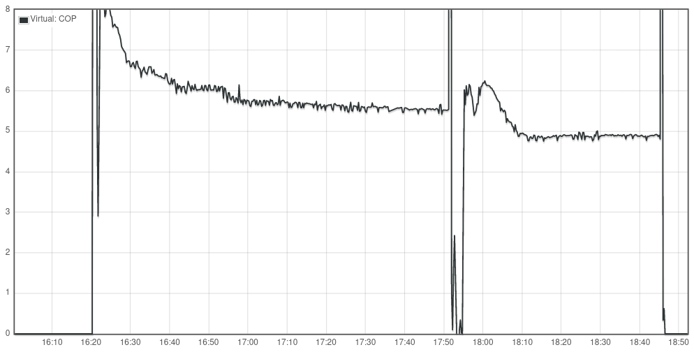

Click ‘Changed, press to save’ and then open the Virtual Feed in the graph view. If you are calculating CoP you may want to set minimum and maximum limits on the y-axis as the calculation can momentarily go off the scale when the compressor starts and stops:
The CoP calculation here is done on the fly from the underlying heat output and electricity consumption feeds. The Virtual Feed does not use any additional disk space, and because of this, Virtual feeds created on emoncms.org are free, they are not included in the pay-per-feed billing.

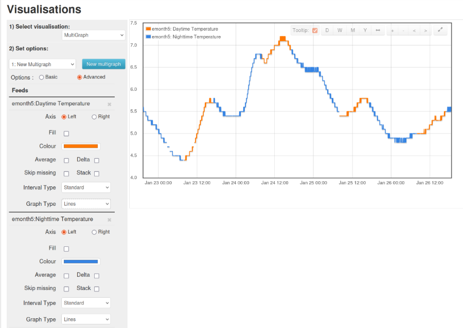

Here is another example, this time using a single schedule to indicate from 8 am until 5 pm is ‘daytime’ and everything else is ‘night time’. Take care with the negative logic. The Virtual Feeds look like this:
and the Multigraph visualisation settings and the graph they produce:
