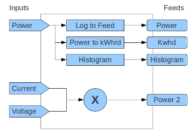

Inputs hold the latest value from a device. Input processing runs a list of steps on each new value, and can scale, combine or convert it and log the result to feeds. Virtual feeds use the same process lists, run when the feed is read.
Input processing concept
For the user view, see Inputs in the user guide.
Flow
  1. Data arrives at input/post or input/bulk, or from MQTT through scripts/services/emoncms_mqtt.
  2. Modules/input/input_methods.php finds or creates each input for the node and key, and stores its value and time. With Redis enabled, inputs are held in Redis.
  3. For each input with a process list, it calls Process::input($time, $value, $processList, $options) in Modules/process/process_model.php.
  4. input() runs the steps in order. Each step receives the value returned by the step before.
For a virtual feed, the feed engine Modules/feed/engine/VirtualFeed.php calls input() once for each datapoint it returns, with $options['sourcetype'] set to ProcessOriginType::VIRTUALFEED.
