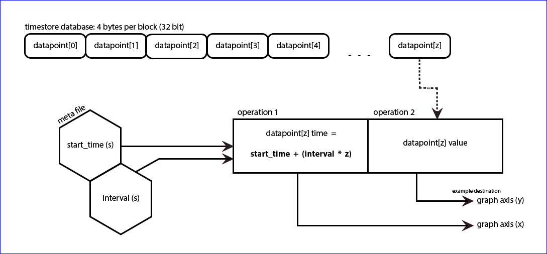

In most applications time series data is recorded at a fixed interval. A temperature or power measurement is made every 10 seconds, minute or hour. With data this regular, the timestamp of each datapoint does not need to be recorded. The start time and interval are stored in a meta file, and the data file holds only the values. The timestamp of any datapoint is calculated from the start time, the interval and the position of the datapoint in the file.

Data file <id>.dat, one 4 byte float per interval:
Fixed Interval data file structure
