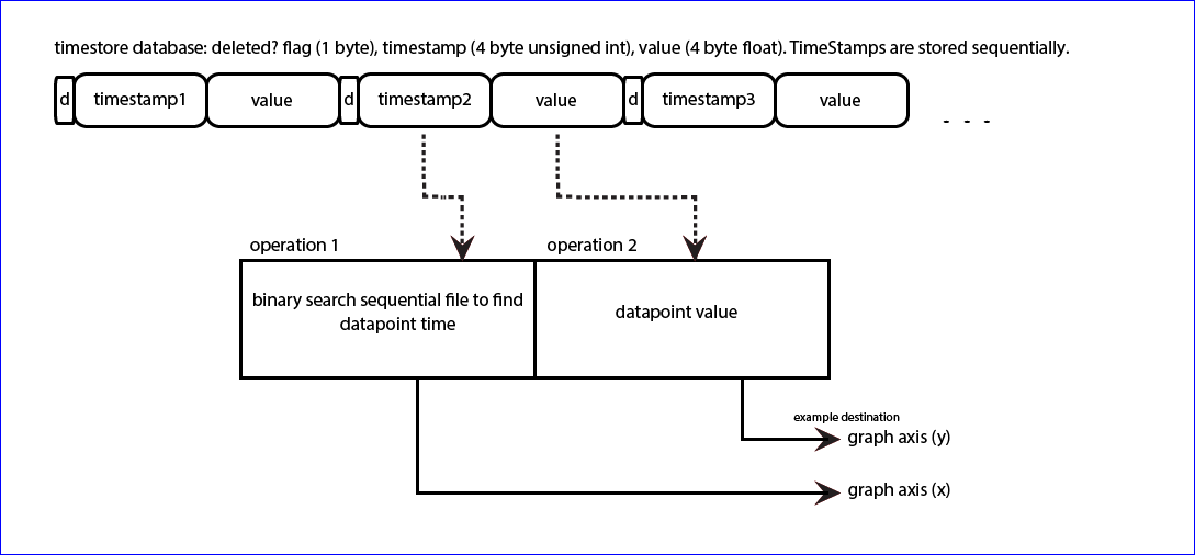

Variable interval storage such as PHPTimeSeries records the timestamp along with the value for each datapoint in the data file. The datapoints are only allowed to be written in ascending timestamp order, so the data file is always ordered. The timestamp can then be used as an index, and a binary search can find the datapoint at any given time.

Each datapoint is stored as fixed length binary. In PHPTimeSeries each datapoint is 9 bytes long. The first byte is a flag, the next 4 bytes store the timestamp as an unsigned integer and the last 4 bytes store the value as a float. With fixed length binary, the start and end of each datapoint are known without searching the file for line endings or other markers. Each datapoint starts at a multiple of 9 bytes, and the number of datapoints is the file size divided by 9.c this

Binary search
Fetching a datapoint at a given time requires a search of the file for the datapoint closest to the requested time. A binary search does this efficiently. It requires ordered data, and timeseries data is ordered by ascending time.
A binary search reads the datapoint at the file midpoint and checks whether the requested time is in the first or second half. It repeats this on the selected half until it narrows down on the datapoint. This usually takes around 20 iterations. This is much faster than a brute force search which may need to read the whole file, which can hold millions of datapoints.
