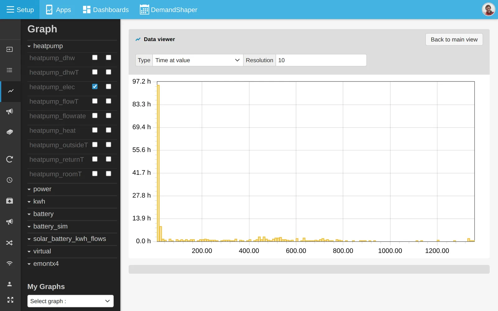

Time at value
The first histogram mode shows the amount of time spent at a given range.
This could be useful for determining the amount of time a heat pump spends at standby as an example. Here we see that the heat pump spent ~1,123,200 seconds between 0-50 Watts out of a total time of 2,592,000 seconds selected in the data viewer. This tells us that the heat pump is on standby for 43% of the time in this period.

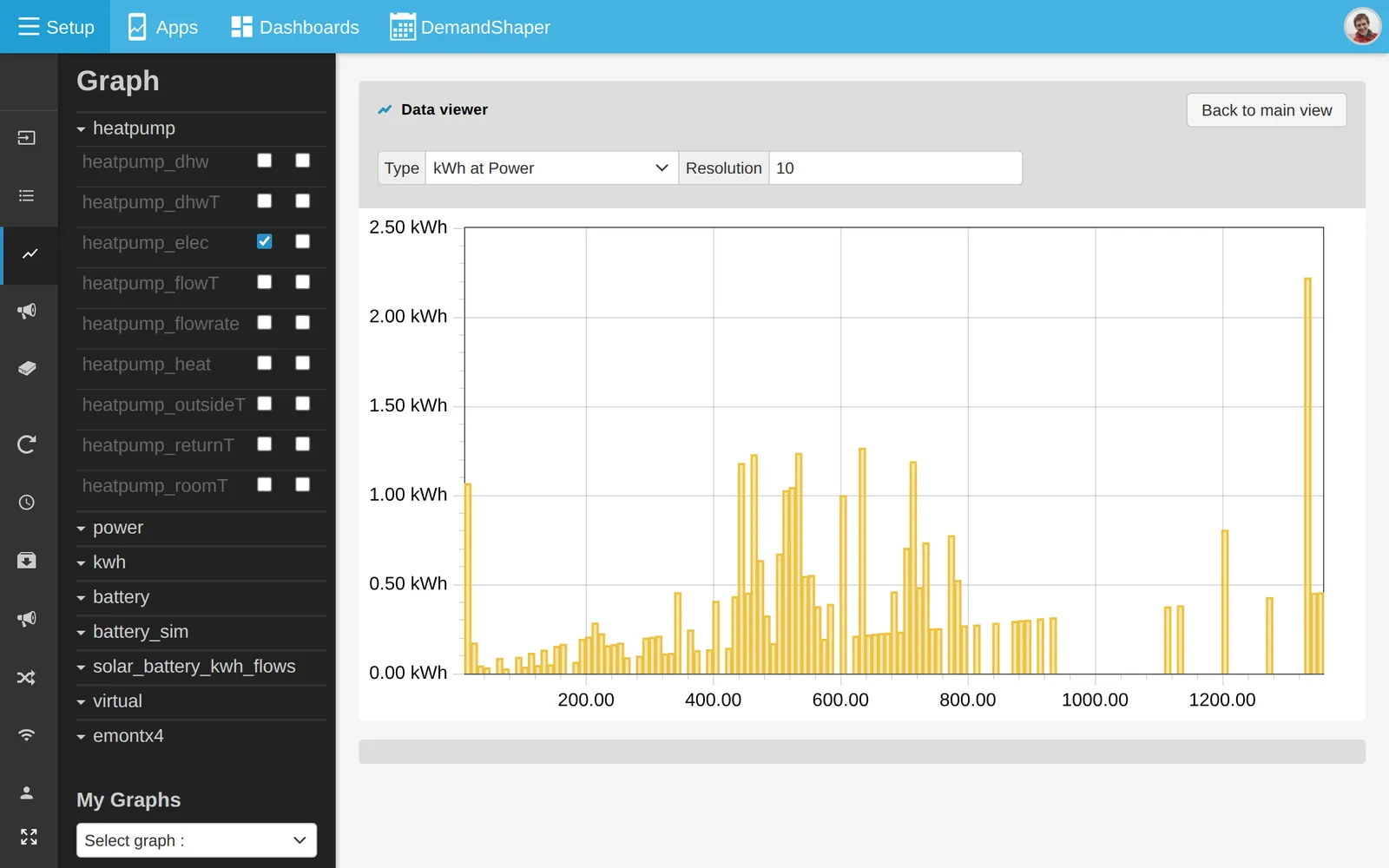

kWh at power
The kWh at power mode is useful for determining the power level where most power was used or generated, In this example we can see that most of the energy used by the heat pump was consumed in the 500-549 Watt segment (97 kWh).
